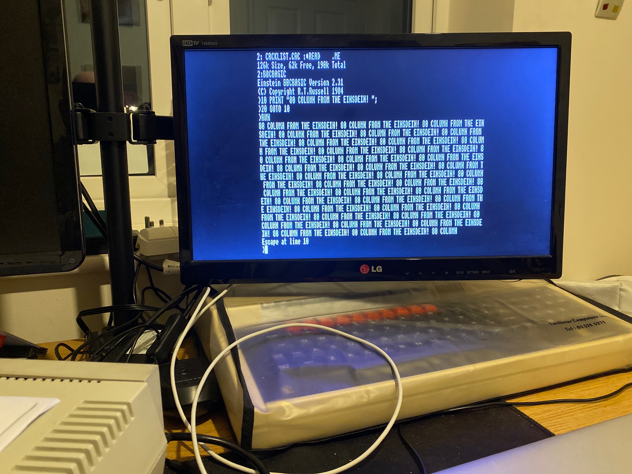

All loaded from the einSDein!
Starquake:
Chuckie egg:
And BBC BASIC:
Which impressively seems to be ok with 80 column mode ‘out of the box’!
