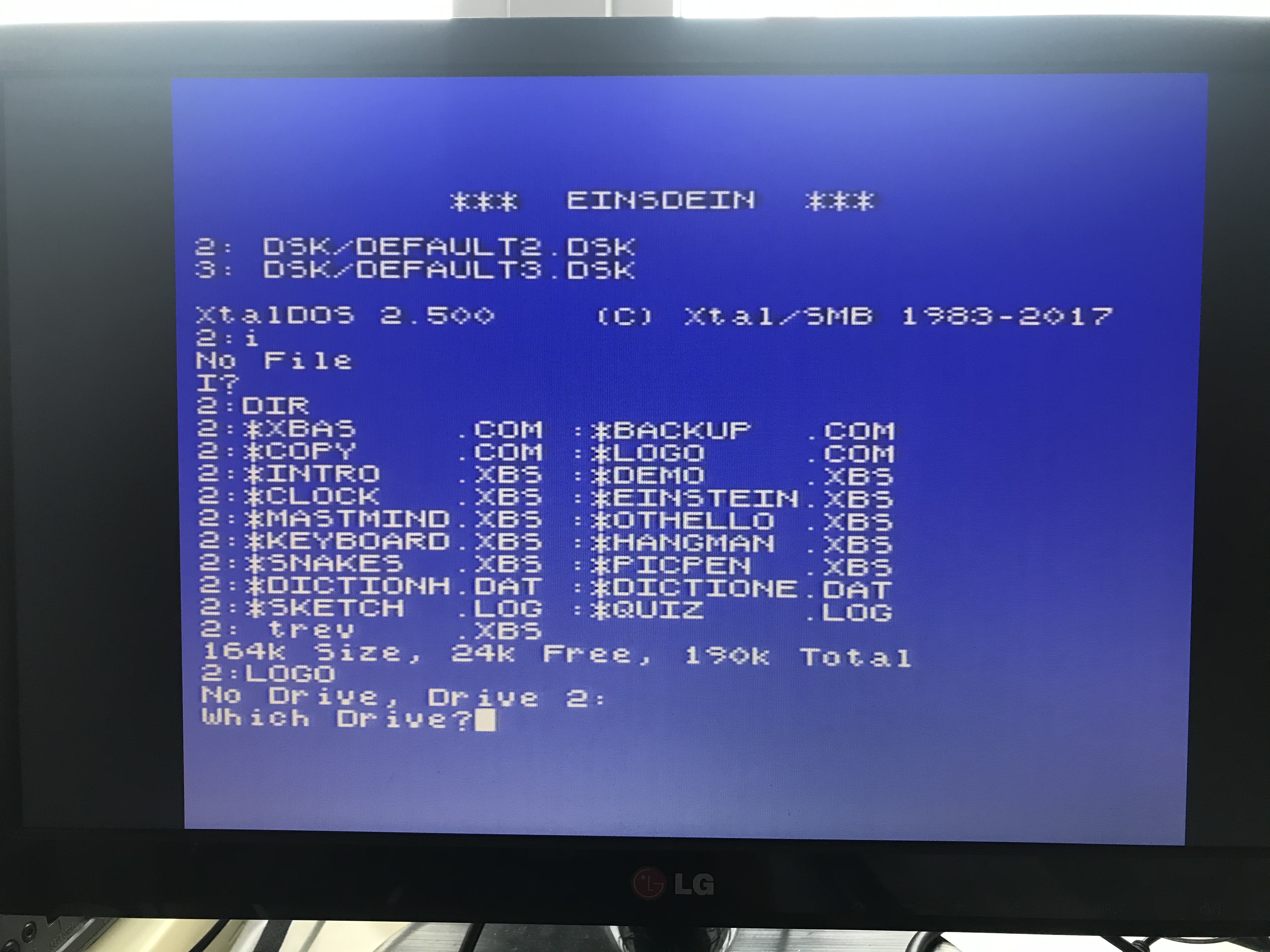

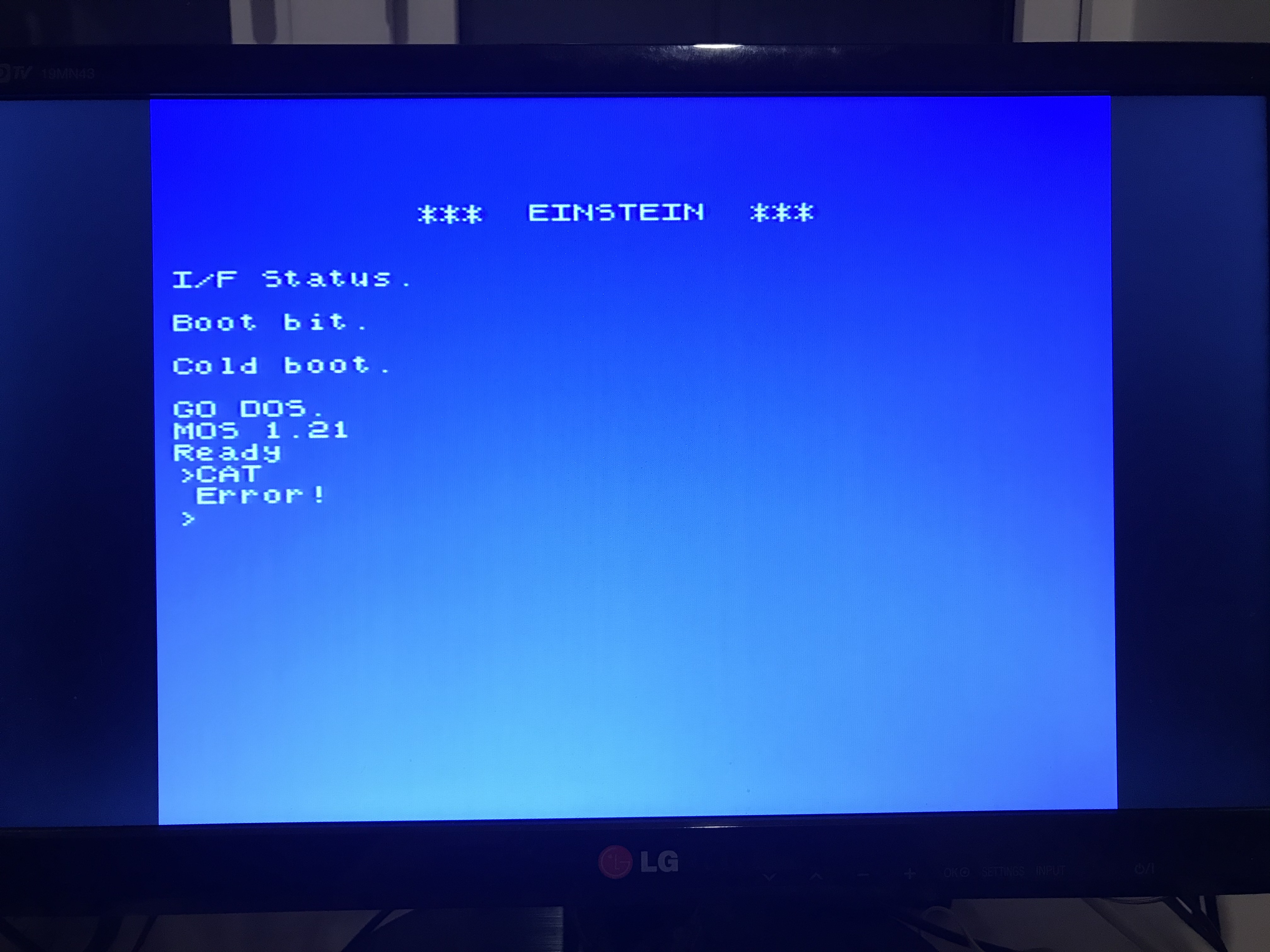

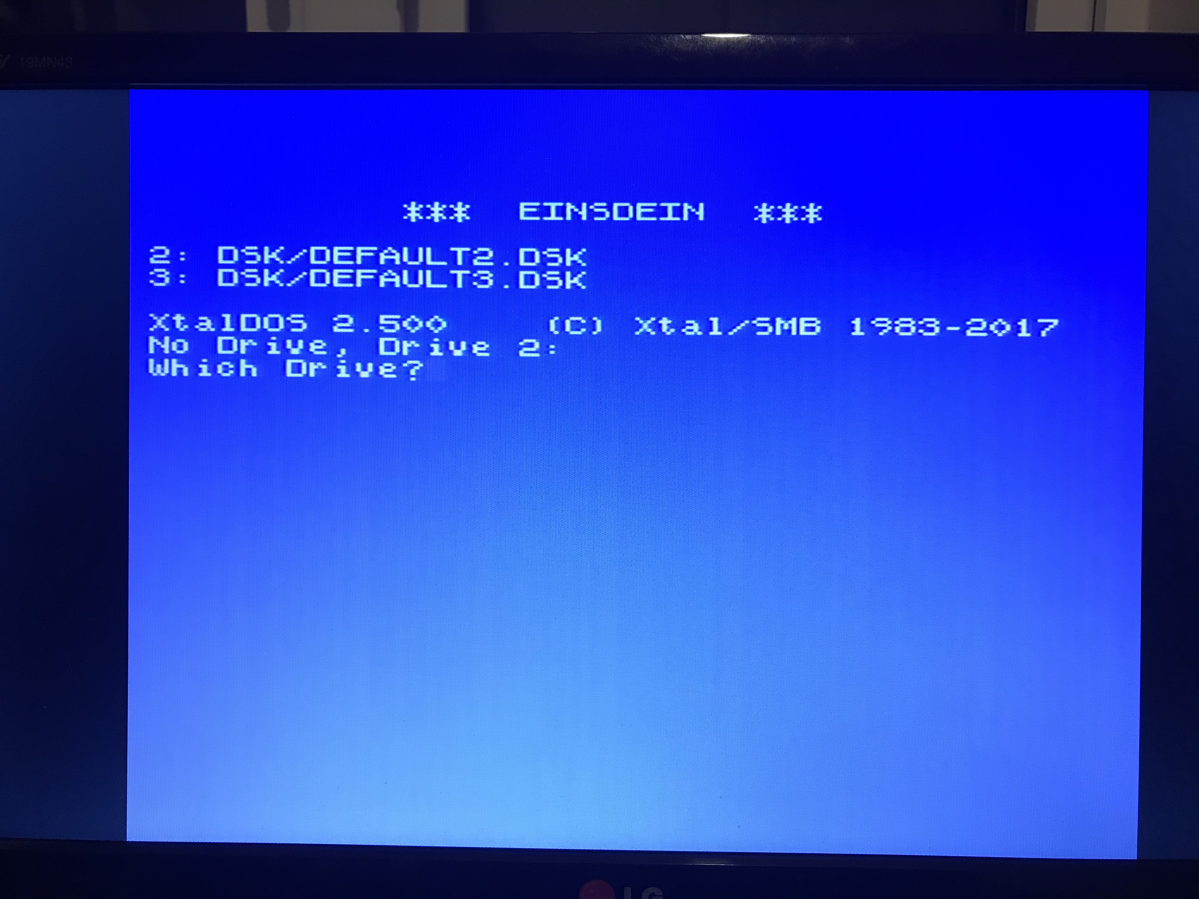

Not necessarily related to my keyboard but more likely the general instability of my tatty I am having troubles with the einsDein.
Sometimes when I switch on I get this:
Sometimes when I get a no discs in drive 2 or 3 error:
Sometimes it works and does DIR (keyboard permitting) and then fails:
I have cleaned the PIPE pins a couple of times.
So presumably it either doesn’t like the SD card or my flaky tatty?

It looks remarkably like the symptoms that Mr. vanpeebles has been seeing. It'll be interesting to see how his z80 transplant goes. I don't think this is an SD card issue. If you're worried that it's a defective board then I'll be happy to re-test it for you. I don't think it is though, as I had vanpeeble's board back for testing and it checked out fine :? Out of curiosity is your einsdein ROM an EEPROM (no window) type or a regular EPROM?
