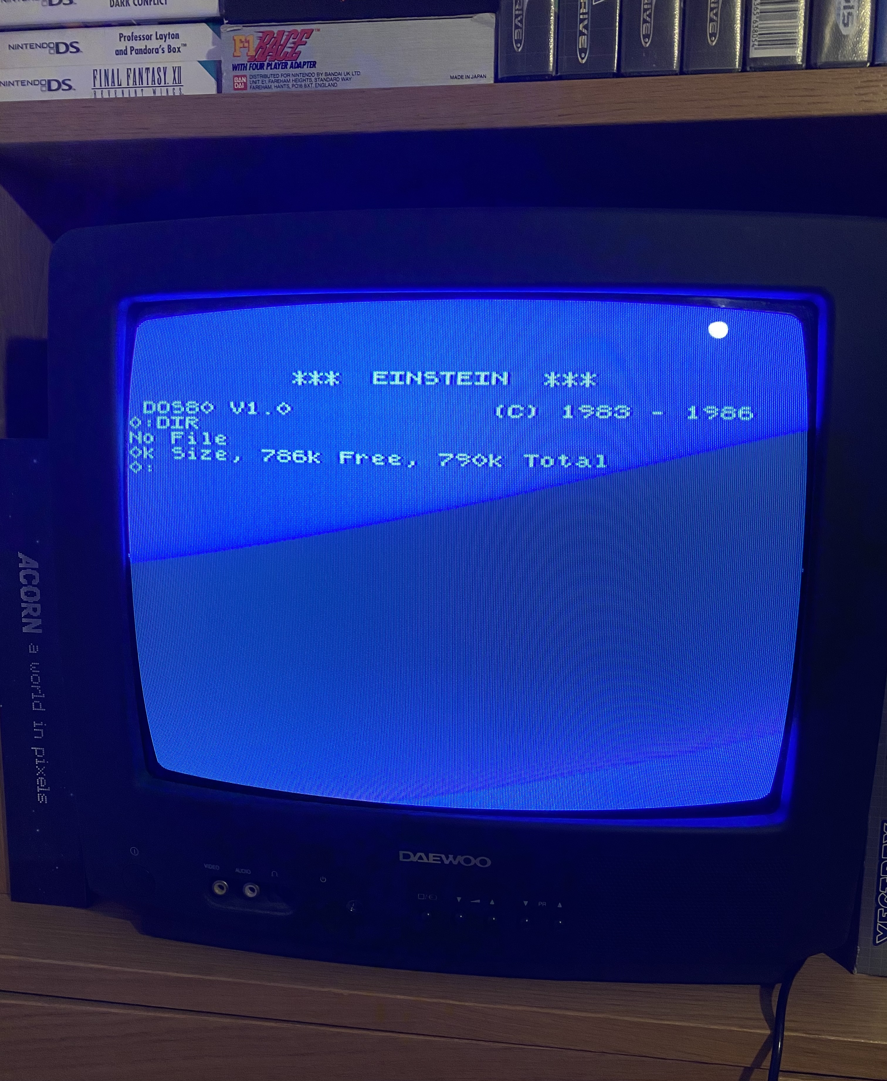

Thanks! I now have a bootable 800K image for drive 0.
It didn’t crash after formatting the HFE image so went very smoothly thanks. :D

Here is a blank 800K image.
It assumes that drive 0 is 80T double sided (800K) and all other drives are 40T single sided.
