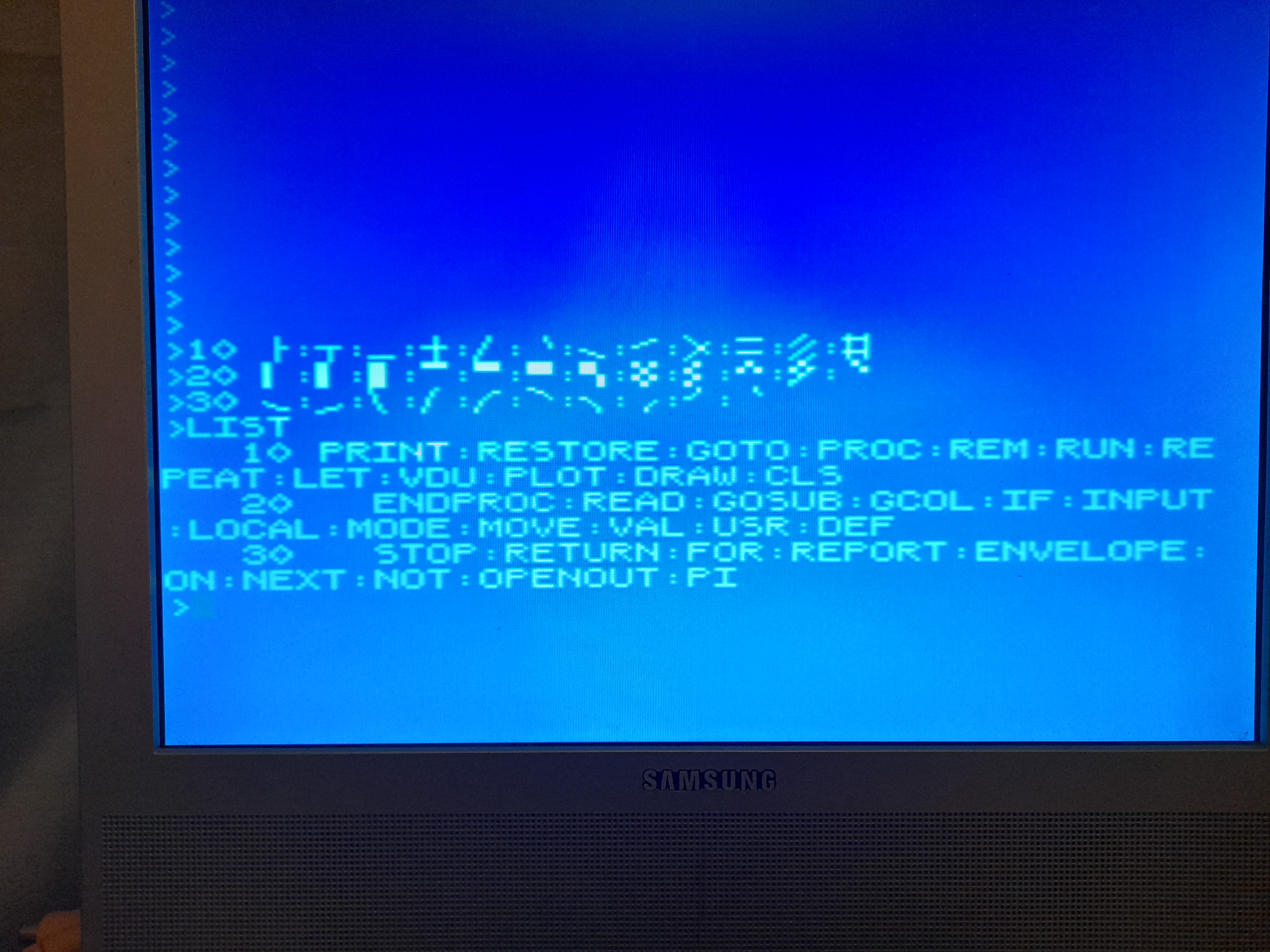

In my attempt to find a way of displaying a square bracket I stumbled across this:
Every gfx character has an associated command in BBC BASIC. I may have missed it but I couldn't find a reference to it in the manual, is this a known thing?
Will be great for creating 10 liners: https://gkanold.wixsite.com/homeputeriu ... -list-2022

I thought I'd tried this earlier but I must have done it wrong.
You are both right. The left and right arrows are transformed into square brackets in the special 80 col font, they can also be used instead of square brackets in BBC BASIC.
So I now have access to the inline assemble in BBC BASIC :)
This little journey also discovered (at least for me) a killer abbreviation system for the 10 line competition.
