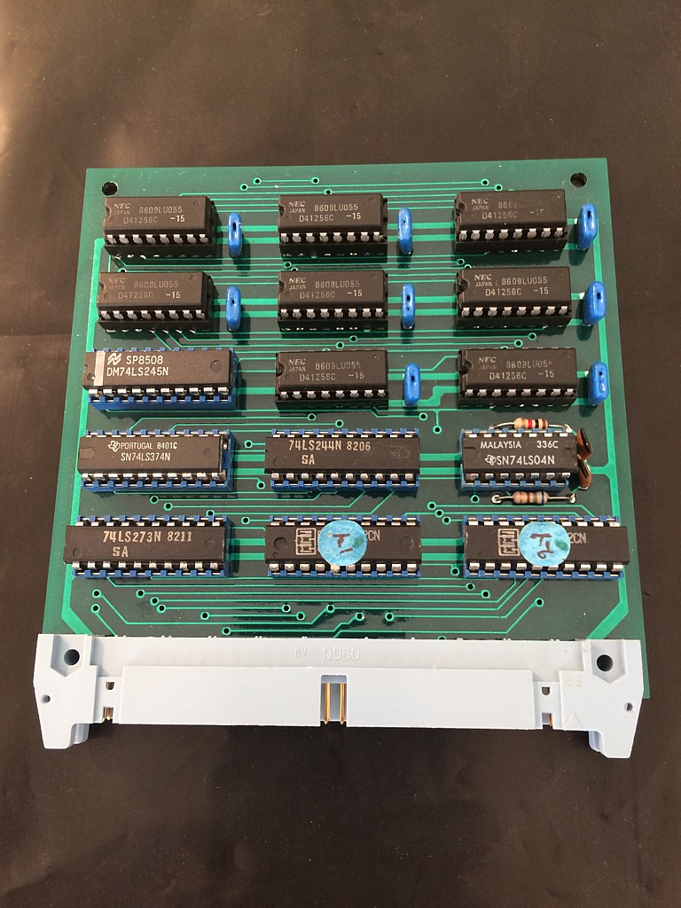

Silicon Disc
Post by Tony Brewer »
To avoid a lot of irrelevant comments in the Speculator topic, I've created a new one for the Silicon Disc, a 256 kilobyte RAM drive I designed in 1986. I have enough original PCBs to assemble and sell more than 100 of these. However my Einstein and monitor are stored in the loft and due to more urgent issues I won't be able to look at this until November. In the meantime, I've moved the photo of the Silicon Disc here.
Tatung Einstein Silicon Disc board photo
