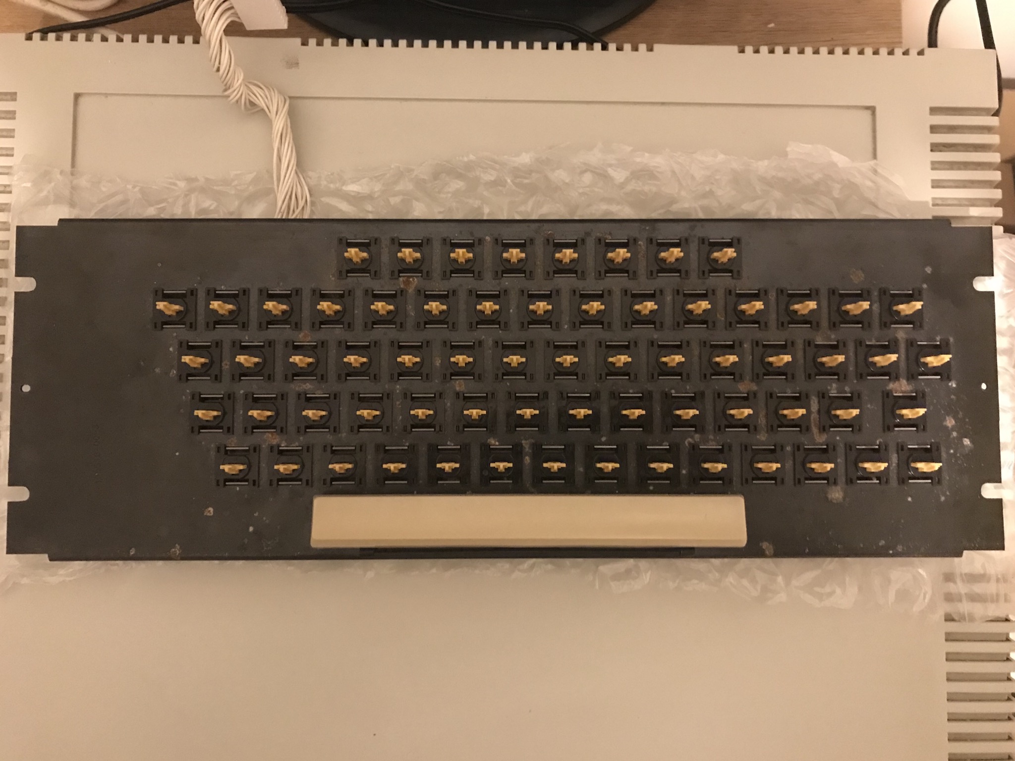

Here is the keyboard:
Didn’t want to risk removing the space bar. They are often a bit complex...
Is it possible to pull the keyswitches apart on these, should it come to that?
Re: Keyboard troubles
You need to:
1) Desolder the switch
2) Pull apart the mechanism with a flat screwdriver. Be gentle!
This keyboard can be fixed 99% of the time...

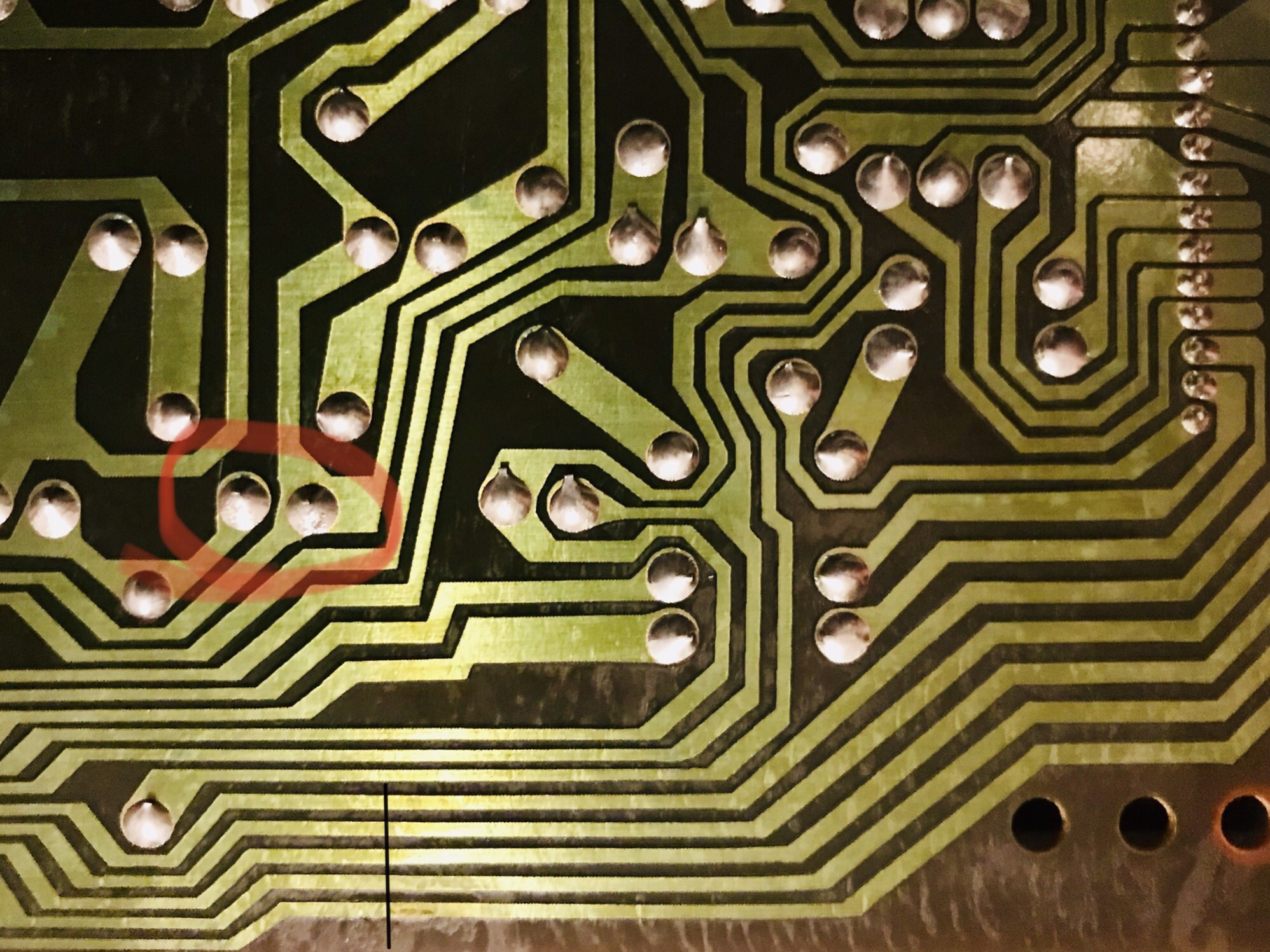

Thanks for looking into this. So far I have checked continuity at the back of the keyboard. All the keys except Z show continuity at the back when pressed in. If I put the probes on the back of F1 or A and press the key I get a nice buzzing sound. I just get the sound of silence on Z.
I am wondering at this stage if the problem is with the key switch itself?
Below is a photo of the back of the Z keys pins.
