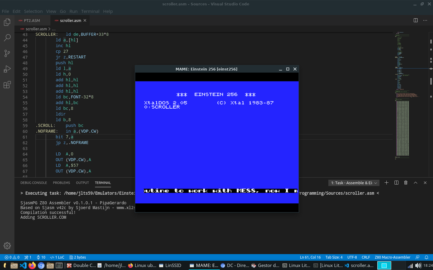

It works!...after some fixes...
Seems that with my Linux (yes, this time I'm using Linux) setup has some compatibility problems with the sources of dsktool and I've been forced to make some changes.
I'm using latest Linux Mint (Ubuntu Bionic based) with x64 GCC 7.5.0 and seems that the support of C++17 features is limited; so I've changed some things to turn it into a compilable tool.
Next, using it as part of a VSCode task I've created a handy toolchain to work with assembler files:
I can launch a TC01 or TCS256 emulation at will.
Now I need to find a way to autoexecute a .COM file when booting a disk and I'll be happy forever :D

Thanks!, that's it, I've found a detailed description in "Einstein Compendium", AUTO-BOOTING chapter in page 59.
In the meanwhile, as it's only to finish the toolchain with an autoexecution, I've used a MAME feature and added some autoboot commands to autoexecute my compiled program:
Code: Select all
-autoboot_delay 4 -autoboot_command "PROG\n"
The above parameters make MAME to wait 4 seconds and then, auto-type PROG+ENTER to run PROG.
Good enough!

Yep, my first approach was also to poll the interrupt bit of the VDP; but I was curious about the interrupts framework of the Einstein. Pretty different to the others I know, I've been learning from your sources (biggoil project) and found the CTC routines to setup an IM2 interrupt and I've tied this to the VDP 50Hz vblank. Of course, using MAME I can clearly see that the CTC interrupt drifts slowly from the vblank.
Now I want to check it with the real machine to see how accurate is MAME (I guess not too much). Anyway, these methods are good enough to play music & sounds and to increment a frame counter so I think it's solved for now.
