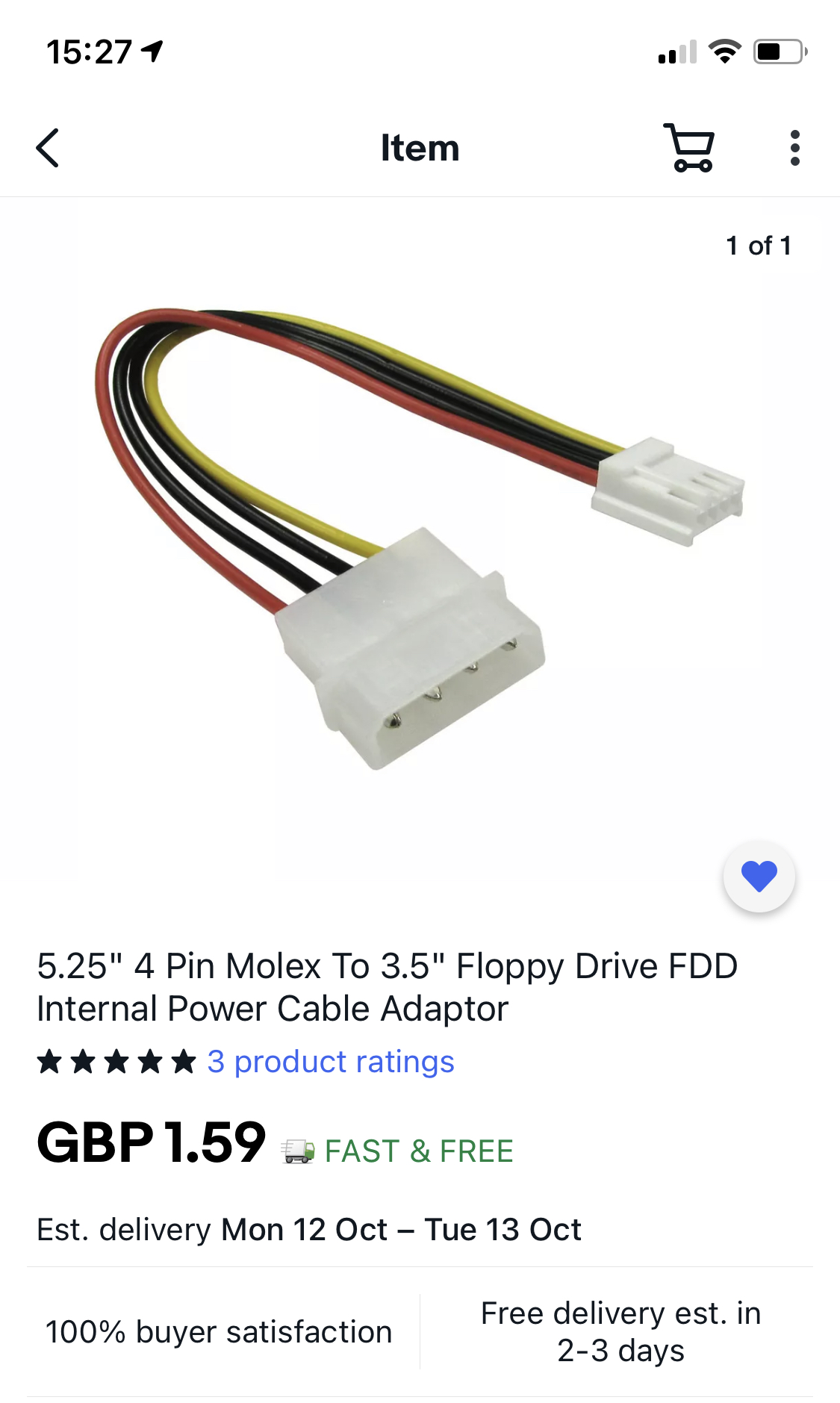

It looks like I may need one of these to hook up the power internally?

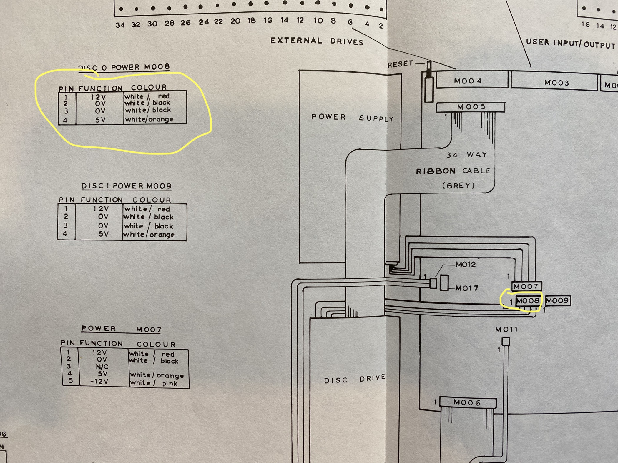

Do I need to swap the 5 and 12V cables around at the gotek end? I see that someone selling kits (https://www.simulant.uk/shop/Tatung-Ein ... earch=Tc01) suggests this is required?
A look at my hardware manual also suggests this is the case:
Re: Fitting a Gotek to my TC01
I think the main thing to watch for is the voltages. On the 256, I need to swap two colours round, so the 12 doesn't go the 5.

Typically the molex adaptor is nowhere near long enough. That comes from ordering blind I guess.

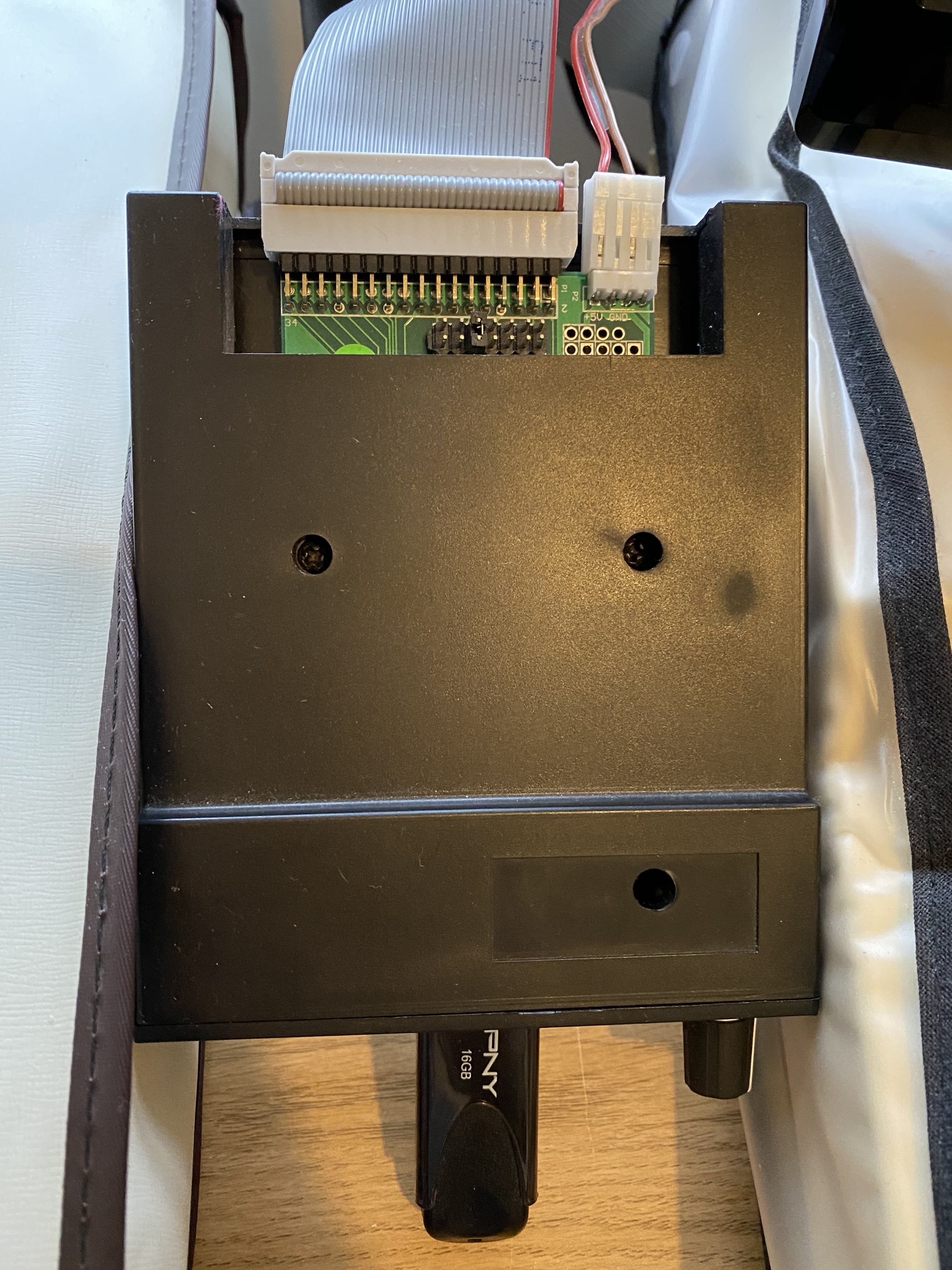

I tried plugging the gotek into the external drive port but just get no sector 0 or similar. I will clean the pins properly and give it another try.
I unplugged the main drive connector near the back and plugged the gotek floppy cable into it and it worked a treat! My Beeb is currently supplying the power as it has a long cable. :D

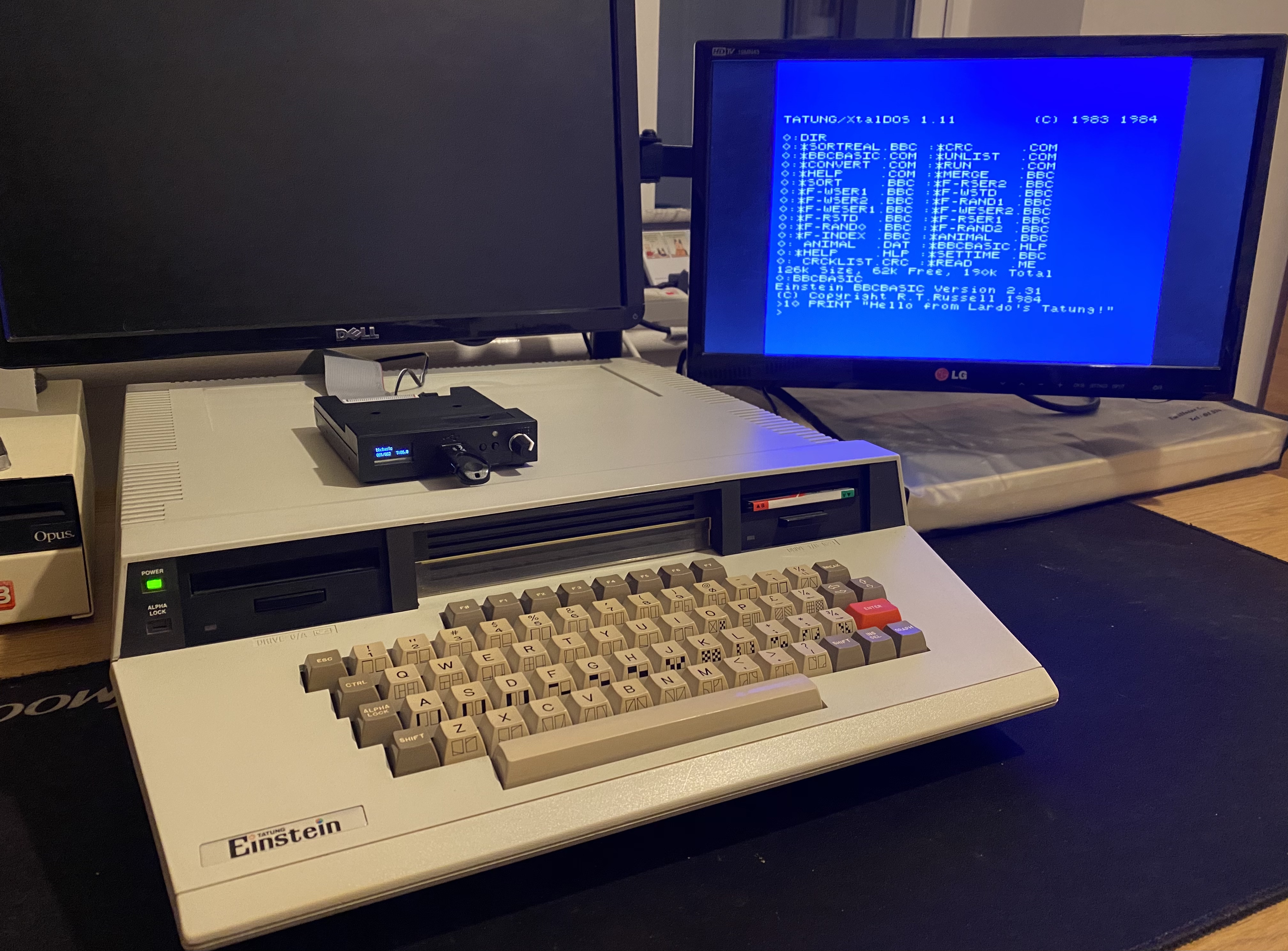

Cleaned the pins on the external drive connector and all good!

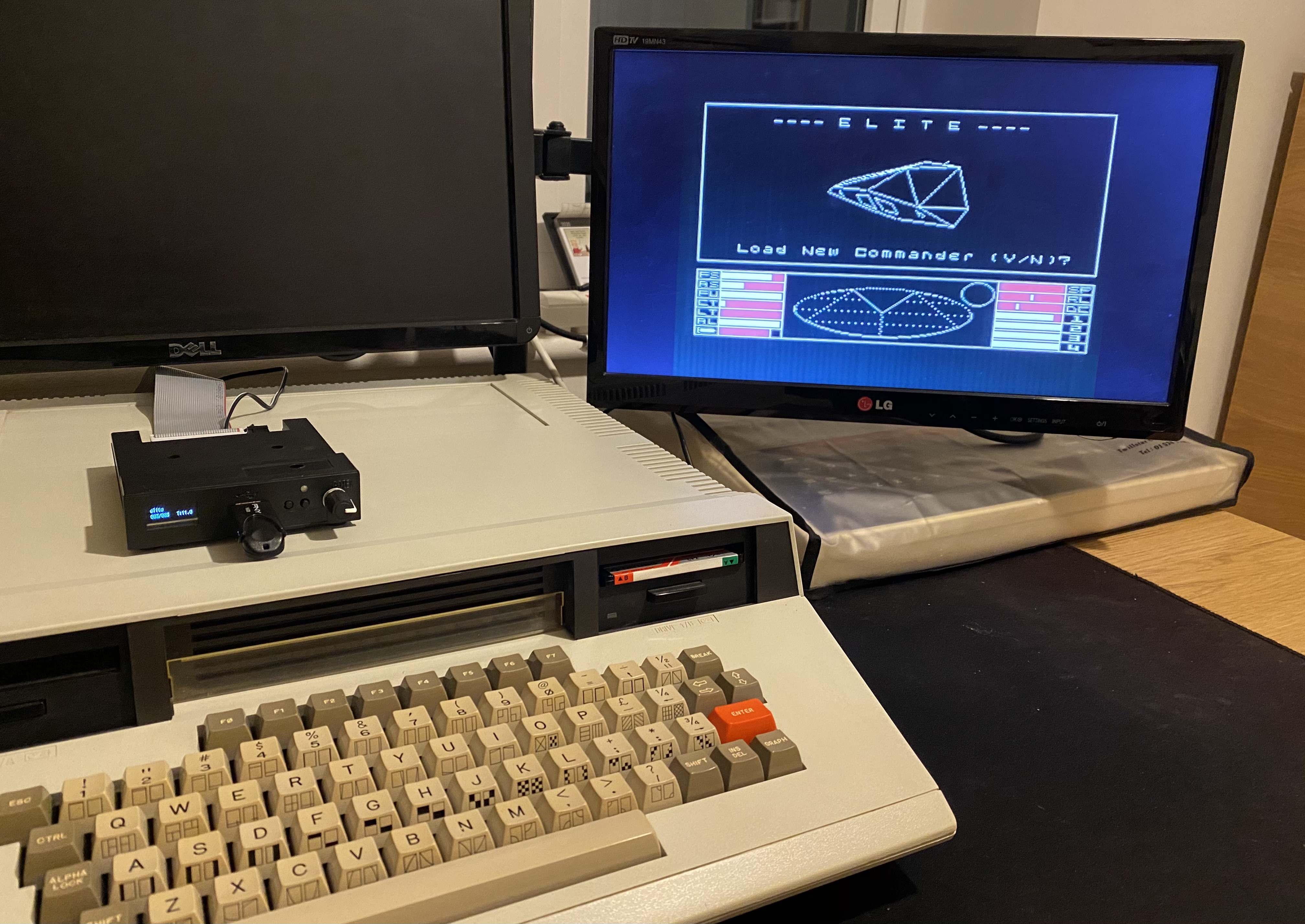

I now have my beeb gotek connected to the external drive connector, I stole a PSU from my Amstrad CPC 6128 external gotek and connected it all up. I disconnected the power to the original internal drive 0
My gotek is now drive 0, my internal drive 1 is still drive 1. The internal drive 0 is doing nothing at the moment.

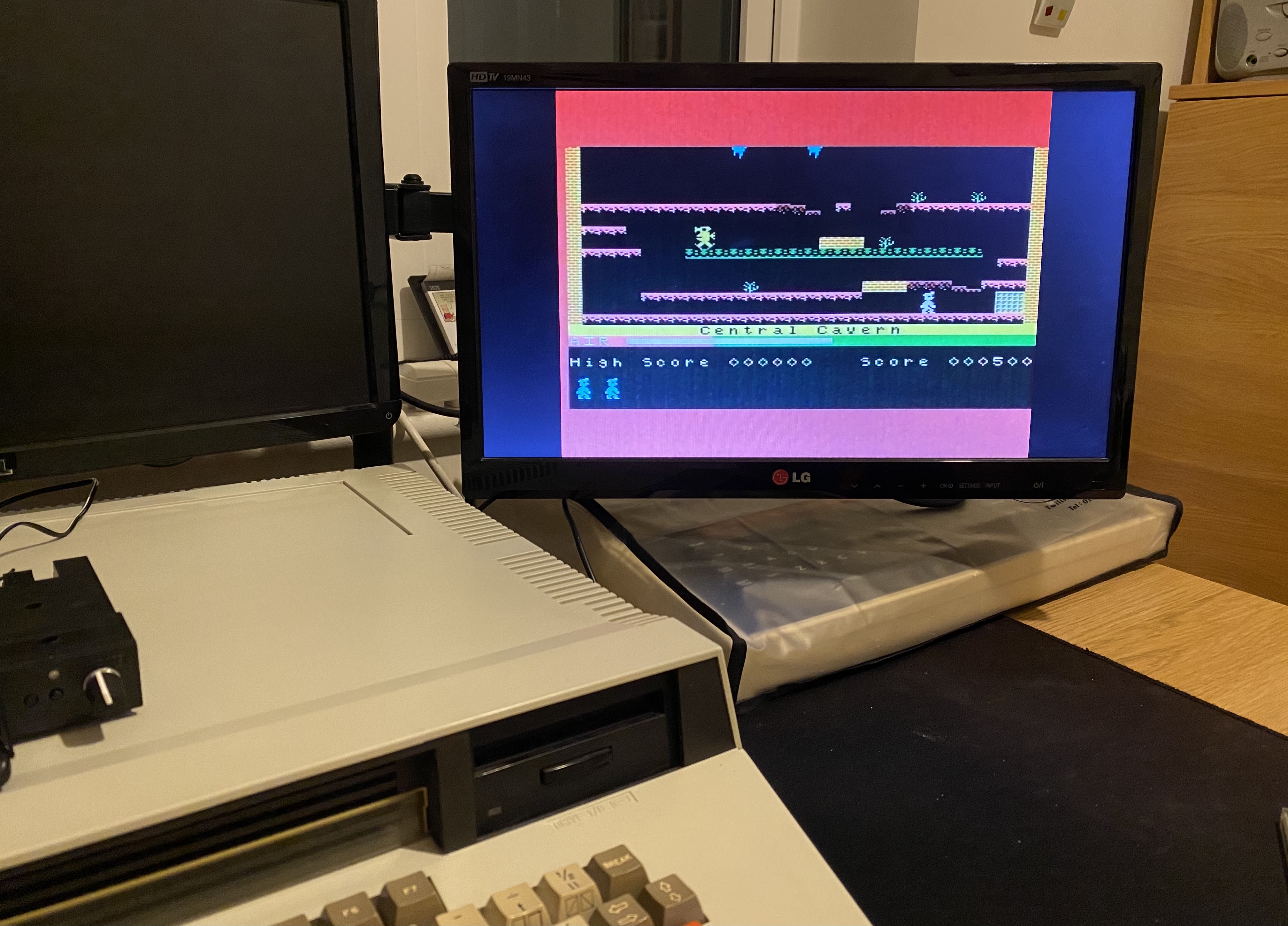

Would be rude not to...
And a really good version of Manic Miner!
