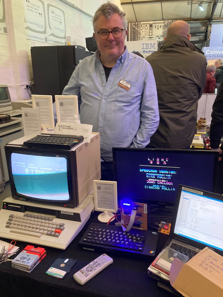

Here it is in action at The Centre for Computing History in Cambridge last weekend. Used it to assemble one of Mike Follin's source disks and get an early Magnum Lightgun proof of concept demo up and running.
