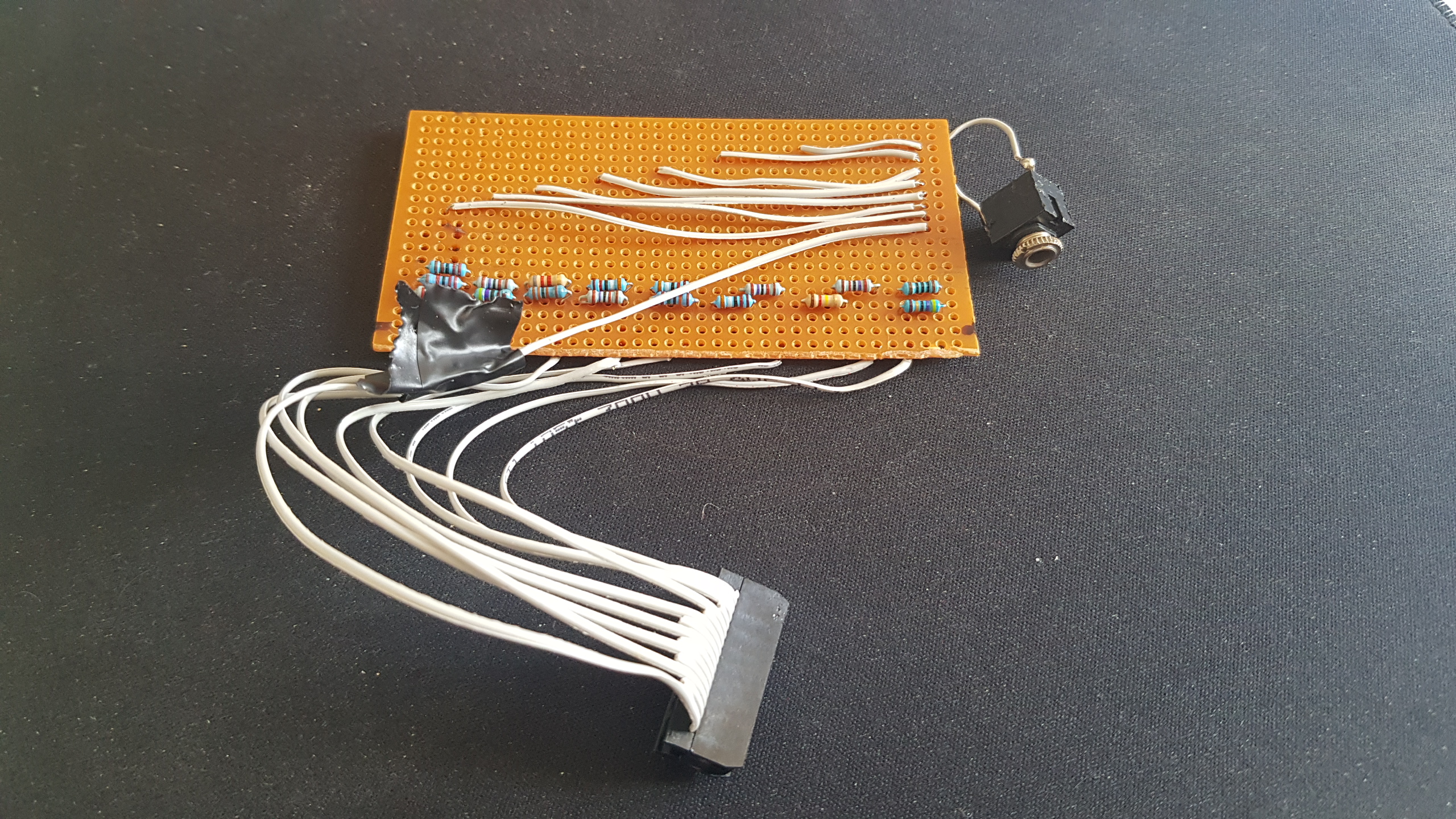

Not really received today, per se, but I have got this very shonky DAC that I made from recently received components.
Unfortunately, I still do not have the PD Music discs that will allow me to use it. I guess I am going to have to program something in basic to try and get some sounds out of it!!
This was constructed from the instructions in Einstein Monthly, Volume 2 issue 3 (October 1988) so I am only shy of 32 years late with this! :D
If anyone has UKEUG PD discs 192 and 193, I would love to have a copy of them so I can furckle with this board. If it works, I have a shed load of spare components so can make another 7 or so (I think) If anyone is interested (If it works!!!)?

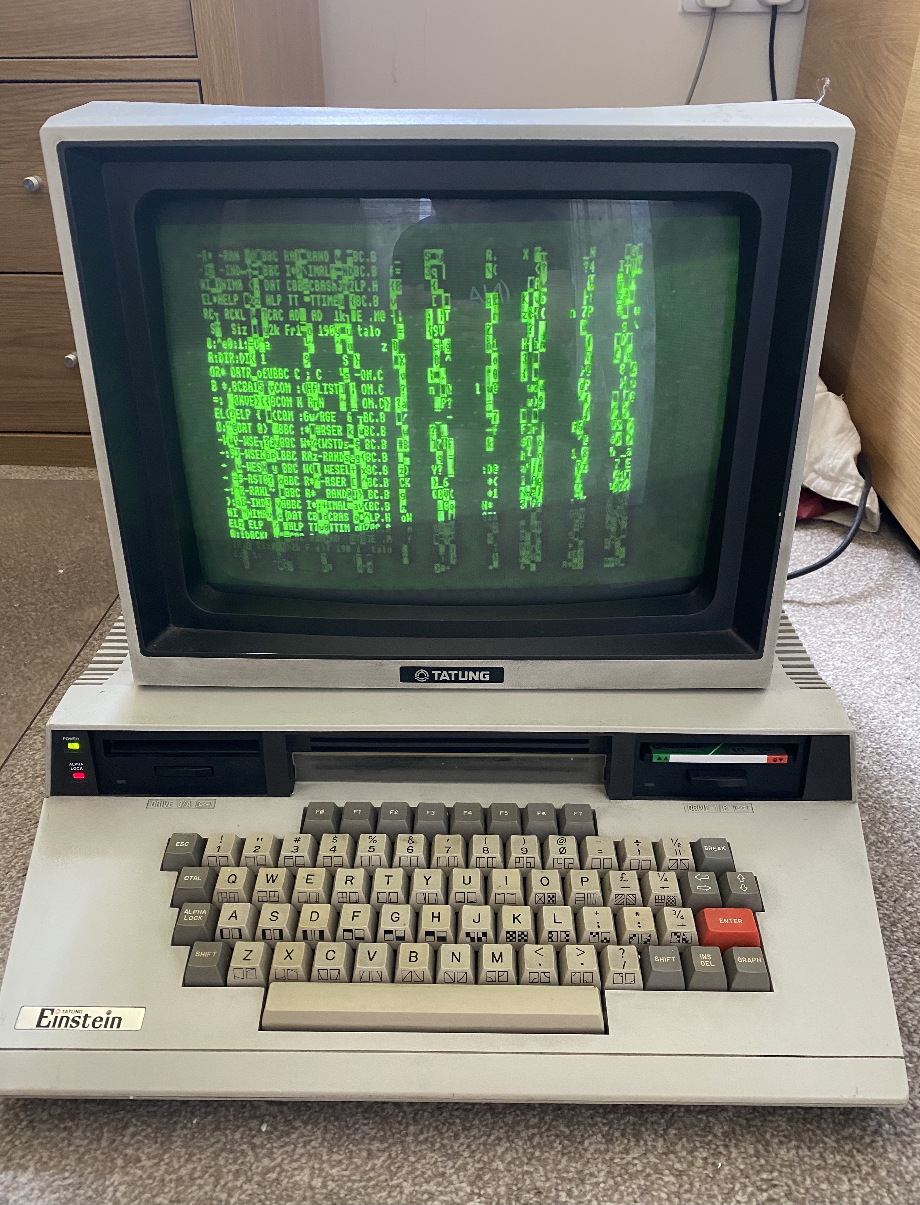

A TC01, TK02 (sadly minus its case) and monitor.
It appears to have the ‘Matrix’ setting enabled…
Both discs work fine and after unplugging and refitting the Pipe connector a few times so does the 80 column card! Pity, the Matrix effect was quite cool. :lol:
The screen quality is really good but doesn’t come across so well in the photos.
