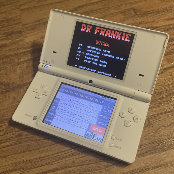

Re: Portable Tatung Einstein Emulation
Ha, that looks really good! :)
