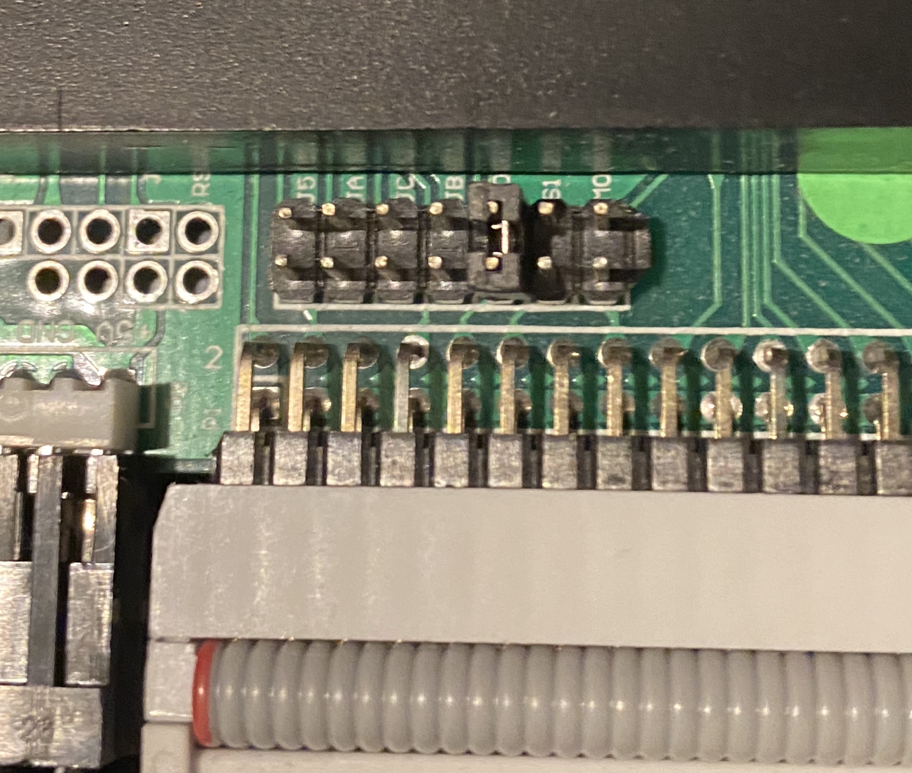

My TC01 has two physical drives but when I plug in my gotek to the external drive port it will only work if I disconnect the power to drive 0 which suggests that it is appearing as drive 0 to the computer.
Any idea what jumper settings are required on the gotek to allow my drive 0 to work and the gotek to be drive 2?
Gotek jumper settings:

Richard Loxley suggests bypassing the jumpers on the Gotek and replacing them with a rotary selector switch that can also connect to the drive select pins for Drive 2 and Drive 3 on the Gotek 34 pin connector.
https://www.richardloxley.com/2017/04/1 ... py-cables/
I've checked this in principle with DIR and by running a game from my Gotek as Drive 2 (and Drive 3) with a temporary connecting wire in place. And it seems to work!
The Drive 0 select signal is on pin 10. Placing the jumper on S0 passes this to the Gotek.
The Drive 1 select signal is on pin 12. Placing the jumper on S1 passes this to the Gotek.
The Drive 2 select signal is on pin 14. So connecting pin 14 to the S1 pin configures the Gotek as Drive 2!
The Drive 3 select signal is on pin 6 (see the Hardware Manual). So connecting pin 6 to the S1 pin configures the Gotek as Drive 3!
So it would seem that it's not as impossible as I thought to configure a Gotek as Drive 2 or Drive 3 on the Einstein!
